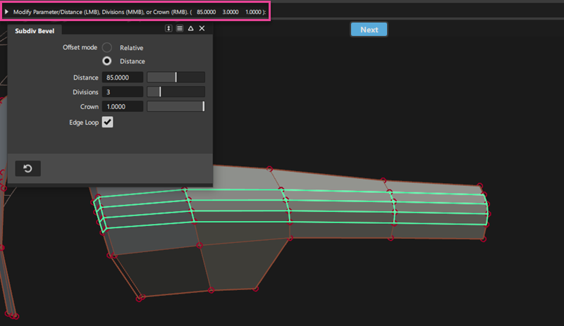

You can now input values into the promptline to modify specific settings when using the Bevel, Cut, and Insert Edge tools.
Use the promptline to modify these settings while the tools are active:
- Subdiv Bevel - Parameter/Distance, Divisions, and Crown
- Subdiv Insert Edge - Parameter/Distance
- Subdiv Cut - Offset
