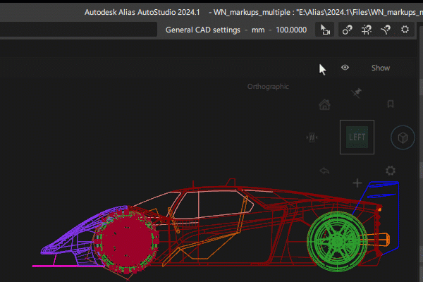

Camera Based Selection toggle
You can now toggle Camera-based Selection on and off without having to open the Selection Option window. It has the same effect as toggling the Camera-based Selection from the hotkey. For example, in the Hotkey Editor see Special > Generally Useful Functions > Camera-based Selection.
  • Click the icon in the top-right area of the view window to turn it on.
  • Click the icon again to turn it off. The promptline verifies the current Camera-based Selection state.

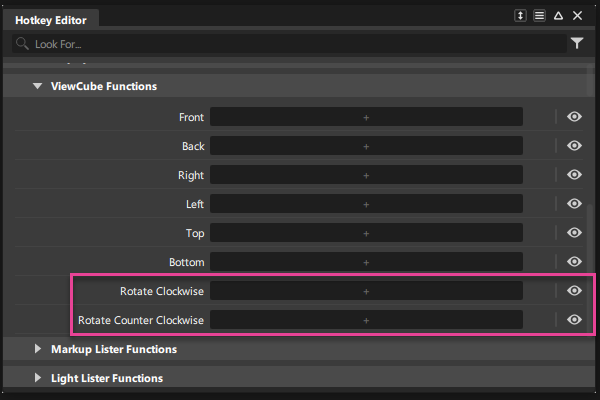

Special Hotkeys for ViewCube Rotation
We've added the ability to assign hotkeys to the ViewCube rotation. In the Hotkey Editor, look under Special, then ViewCube functions. Here you can assign hotkeys for Rotate Clockwise and Rotate Counter Clockwise.
