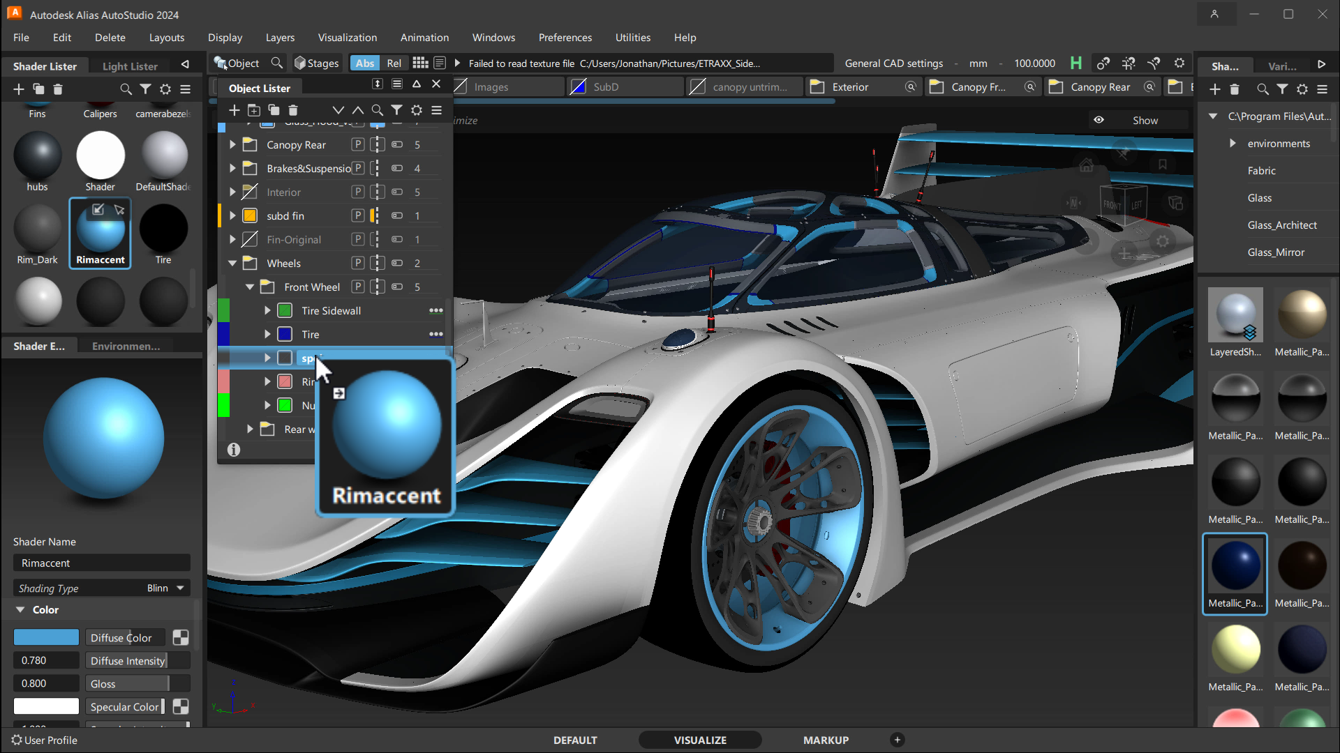

  • There are now more ways to quickly assign shaders to objects.
  • The easiest way is to left-mouse-drag a shader from the Shader Lister onto single surfaces in the viewport. to objects.
  • To replace a shader assignment, middle-mouse-button-drag the shader onto the shaded objects.
  • All objects and components with the previous assignment now have the new shader.
  • Another way to replace a shader is to click a shader swatch and then select the Pick Objects icon.
  • All objects with this assignment are selected.
  • Click the replacement shader swatch and then select the Assign to Objects icon.
  • You can also assign a shader by dragging it onto a layer, group, or component in the Object Lister.
  • This method lets you quickly and precisely make assignments.

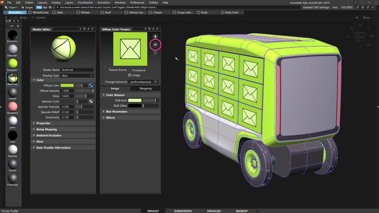

  • Applying texture maps in Alias 2024 has been streamlined.
  • So now the texture editor can appear alongside the Shader Editor rather than swapping with it.
  • And the primary assignment is now the image here in this main section up at the top.
  • And then after that, you can choose or change the projection type here in this new Mapping tab.
  • So I'll start with this simple UV map, and then here I have all the usual 2D placement sliders.
  • And then this image tab has all the settings related to the graphics, so I can add a bit of green or tone it down a bit.
  • Up at the top, you've got an on/off button for the texture or you can delete it completely here.
  • Mapping other channels works in the same way.
  • So for Bump, for example, when there's no slider value, then there's just the mapping button here.
  • So again, I'll start with the image but this time I'll choose a procedural texture, so Noise, for example, and the noise parameters appear here.
  • And over on the Mapping tab,I can now switch from a 2D UV texture to one of the 3D solid textures.
  • And now the 3D placement tools appear at the top.
  • So here I can display the green placement cube and here I can turn wrap on.
  • And here is a new move texture option.
  • So I'll close these and then turn on the manipulator for the green placement cube and then I can move it and scale it.
  • But what I can also do now is switch the source to a file image for example.
  • And then I've kept all this positioning and placement without having to rebuild the texture.
  • And I've got the image parameters here to just fine tune the texture.
  • And then this third icon on the top is just a shortcut for turning off the placement cube display.
  • And then finally, the stencil texture is now integrated into the image tab.
  • So here is a shader that already has a 3D graphic on it, but I can change that to a decal by selecting Stencil and then loading in a mask image and then the white areas of the mask revert to the base shader color, so that I've got a decal that I can move around with the texture placement.
