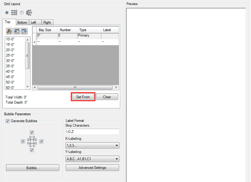

To Create an Enhanced Column Grid From an Existing Enhanced Column Grid or Regular Grid
  1. Click Home tab Build panel Column Grid drop-down Enhanced Custom Grid.
    Alternatively, you can select the Enhanced Custom Column Grid tool on the Design Tool Palette.
  2. In the Column Grid dialog box, click Set From. The Column Grid dialog box temporarily closes.
  3. Select an existing enhanced column grid or regular grid.
    In the Column Grid dialog box, the extracted data of the selected grid is displayed on the Grid Layout table. The preview of the selected grid is also generated and displayed.
  4. If needed, set further properties for your grid.
  5. Press OK and insert the grid in the drawing.
