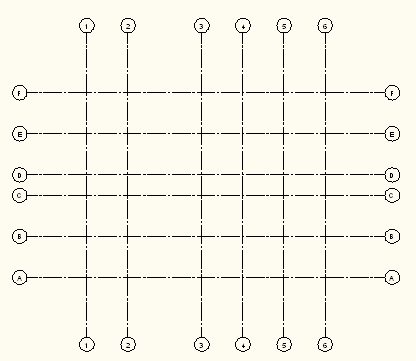

To Create an Enhanced Grid With Different Sized Grid Bays
You can create a grid with differently sized grid bays.

  4. Under Bay Size/Bay Angle enter the first grid bay by clicking the desired value in the preconfigured values list.
  5. For a grid with different sized bays, you need to add one row for each bay. To add a new row for a bay, select the desired value in the list on the left and click it.

  8. Press Enter and insert the grid in the drawing.
    Note: After inserting the grid, you can shorten and lengthen the bay size manually. The new bay size gets automatically revised in the Column Grid dialog box input table.
