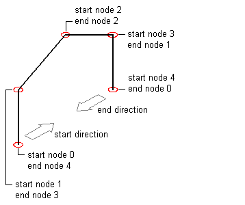

Assign shapes to the rigid frame member relative to the start of the member. The start point is defined as Node 0. The first vertex of the member is defined as Node 1, the next vertex is Node 2, and so on until the endpoint of the member, which is defined as the end node.
Note: If you assign shapes relative to the end of the member, the endpoint of the member is defined as Node 0.
Identifying nodes on the member path
