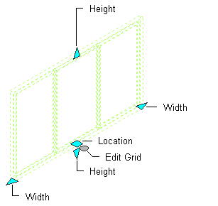

You can use the following grips to edit a door and window assembly:
Viewing Door/Window Assembly Grips
Grip Description
(Width) Lets you change the overall width of a door/window assembly
(Height) Lets you change the height of the door and window assembly
(Location) Lets you move a door and window assembly. If the assembly is anchored to a wall, you can use these three methods:
  • Drag the cursor to move the assembly along the length of the wall
  • Press Ctrl and drag to move the assembly within the width of the wall
  • Press Ctrl twice and drag to move the assembly vertically within the wall
