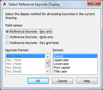

Use this procedure to change the format of all keynotes of a given type (reference or sheet) within a drawing.
- Click
Note: Alternatively, you can click.
- In the Select Reference Keynote Display or Select Sheet Keynote Display dialog box, select an option for Field names. If you select the Key and Note option, you can also select an option for Keynote Formats. You can change the Format setting regardless of the Field name selection.
- Click OK to implement the format changes for all keynotes of the selected type within the drawing.
