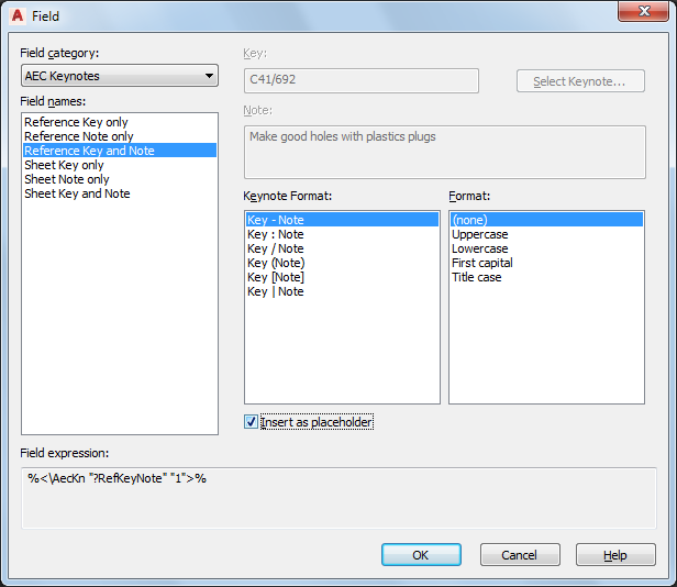

Use this procedure to change the format of a keynote that has been inserted in a drawing.
  1. Double-click the keynote to display the Multiline Text Editor.
  2. In the Text Formatting box, right-click the selected keynote.
  3. In the Field dialog box, make sure the current Field category is AEC Keynotes, and then select a keynote format under Field names. If one of the key-and-note options is selected, you can select an option under Keynote Format. You can also change the setting under Format, if desired.
  4. Click OK twice.
    The selected keynote is reformatted.
