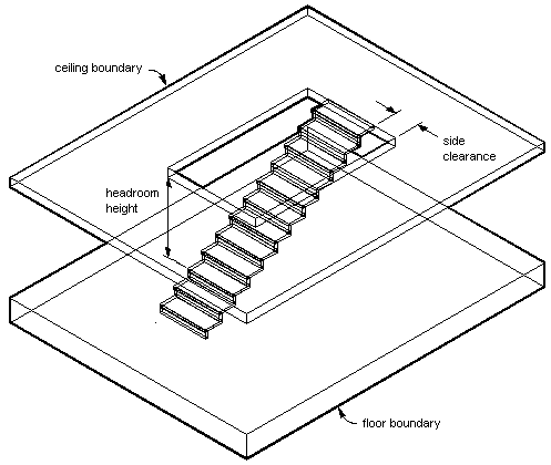

Specifying headroom height and side clearance for a stair and a space object
  1. Double-click the stair to open the Properties palette.
  2. Click the Design tab, expand Advanced, and expand Interference.
  3. Set the size of the interference condition:
    If you want to… Then…
    specify the height above the treads for the interference condition enter a value for Headroom height.
    specify the left and right side clearances for the interference condition for straight and multi-landing stairs enter values for Left and Right Clearance.
    specify the inside and outside clearances for the interference condition for spiral and U-shaped stairs enter values for Inside and Outside Clearance.
