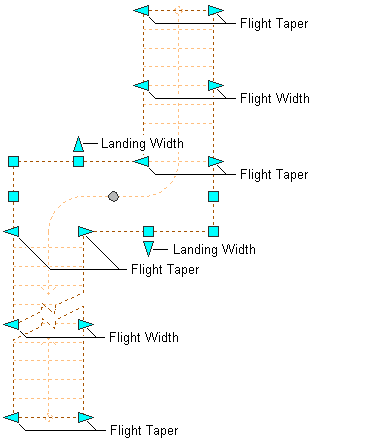

Editing Multi-Landing Stair Dimensions
  1. Select the multi-landing stair.
  2. Select the grip for the dimension you want to change.
    Multi-landing stair landing Edge and Vertex, and Exit Edit Edges grips
  3. Move the grip until the dimension value you want is displayed, and click once; or enter a value.
  4. Click the Edit Edges grip to access the edges edit mode (flight width and flight taper).
    Note: Alternatively, click Stair tabModify panelCustomize Edge drop-downEdit.
    Multi-landing stair Flight Taper and Flight Width, and Landing Width grips
  5. When you have finished editing the stair edges, click the Exit Edit Edges grip to return to the default stair edit mode.
  6. Continue editing, or right-click, and click Deselect All to turn off grips.

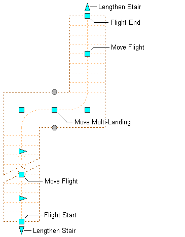

Changing the Location or Position of a Multi-Landing Stair
  2. Select the appropriate grip to change the location of the stair, its start point, construction line, graphics path, or endpoint.
    Multi-landing stair Flight Start and End, Move Flight, Move Multi-Landing, and Lengthen Stair grips
    Multi-landing stair Landing Turn Point, Construction Line Location, Graphics Path Location, and Edit Edges grips
  3. Move the stair to the desired location, and click once; or enter a value, and press Enter.

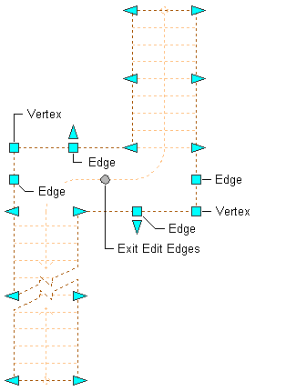

Changing the Shape of Landings for Multi-Landing Stair
  2. Select the Edit Edges grip to access the edges edit mode (landing width, landing edges, and landing vertices).
    Multi-landing stair Landing Edge and Vertex, and Exit Edit Edges grips
  3. Move the appropriate grip to change the shape of the landing of the stair.
    Note: Once a landing edge has been customized by moving any of the vertex or edge grips, the landing width grips are no longer displayed.
  4. When you have finished editing the landing edges, click the Exit Edit Edges grip to return to the default stair edit mode.
  5. Right-click, and click Deselect All to turn off grips.

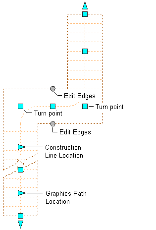

Changing the Location of a Landing for a Multi-Landing Stair
  2. Move the appropriate grip to change the location of the landing by changing the location of the turn point for each side of the landing, or by moving the entire landing.
  3. Right-click, and click Deselect All to turn off grips.
Changing the Construction Line or Graphics Path of a Multi-Landing Stair
  2. Move the Construction Line or Graphics Path grip.
    Multi-landing stair landing Turn Point, Construction Line Location, Graphics Path Location, and Edit Edges grips
    Note: Only one of the Construction Line or Graphics Path can be displayed at a time. This is controlled on the Other tab of the current plan display representation.

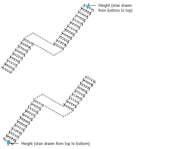

Changing the Height of a Multi-Landing Stair
  2. Move the Height grip to change the height of the stair.
    Note: This grip displays only in 3D views of the stair.
    Multi-landing stair Height grip
