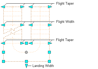

Editing U-Shaped Stair Dimensions
  1. Select the U-shaped stair.
  2. Select the Edit Edges grip to access the edges edit mode (flight width, flight taper, and landing width).
    Note: Alternatively, click Stair tabModify panelCustomize Edge drop-downEdit.
    U-shaped stair Flight Taper, Flight Width, and Landing Width grips
    U-shaped stair Landing Vertex and Edge, and Exit Edit Edges grips
  3. Move the grip until the dimension value you want is displayed, and click once; or enter a value.
  4. When you have finished editing the stair edges, click the Exit Edit Edges grip to return to the default stair edit mode.
  5. Right-click, and click Deselect All to turn off grips.

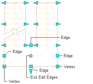

Changing the Shape of Landings for a U-Shaped Stair
  2. Select the Edit Edges grip to access the edges edit mode (landing width, landing edges, and landing vertices).
  3. Move the appropriate grip to change the shape of the landing of the stair.
  4. When you have finished editing the landing edges, click the Exit Edit Edges grip to return to the default stair edit mode.

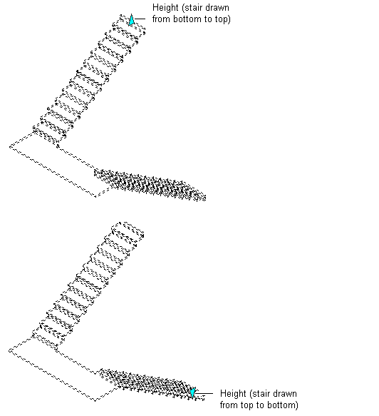

Changing the Height of a U-Shaped Stair
  2. Move the Height grip to change the height of the stair.
    Note: This grip displays only in 3D views of the stair.
    U-shaped stair Height grip
  3. Right-click, and click Deselect All to turn off grips.
