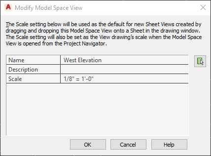

  4. Right-click, click Properties, and change the properties of the model space view as needed:
    If you want to… Then…
    change the name of the model space view enter a new name.
    change the description for the model space view click the setting for Description and change it.
    change the scale of the model space view select a new scale from the list.
  5. To change the model space boundary, click , and redefine the boundaries on screen.
  6. Click OK.
