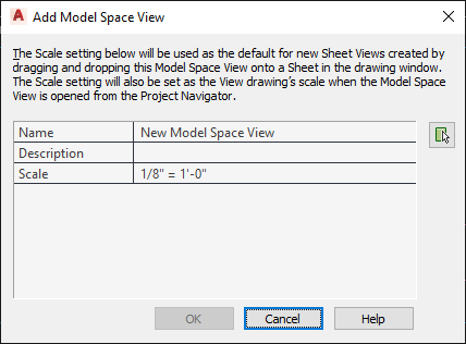

  4. In the Add Model Space View dialog box, enter a name for the new model space view.
  5. Define the settings for the new model space view:
    If you want to… Then…
    enter a description for the model space view click the setting for Description and add a description of the model space view.
    change the scale of the model space view select a scale from the list of those used in the current view drawing.
  6. Click to define the boundaries of the new model space view.
  7. Specify the first boundary point of the desired view area.
  8. Specify the second boundary point of the desired view area.
  9. Click OK.
