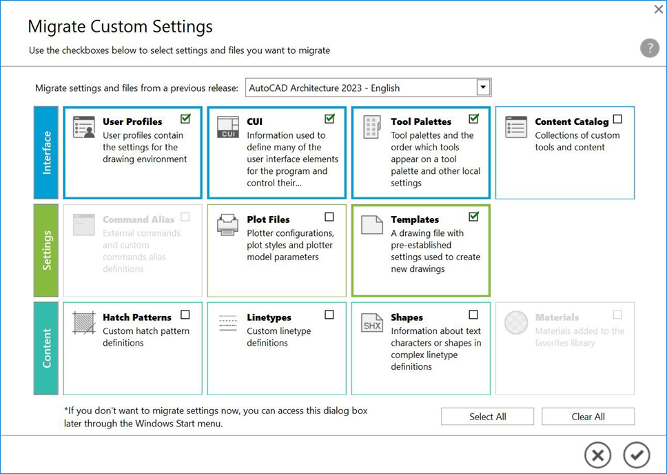

To work with custom settings:
- On the Windows Start menu, click Autodesk
AutoCAD
<product and release> folder drop-down list
Migrate From a Previous Release.
- In the Migrate Custom Settings dialog box, select the release from which you want to migrate.
- Select the custom settings you want to migrate over to the latest release.
- Click
to start the migration process.

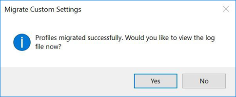

Note: Migration may take some time. - In the Migrate Custom Settings message, click Yes to view the migration log file. Otherwise, click No.
