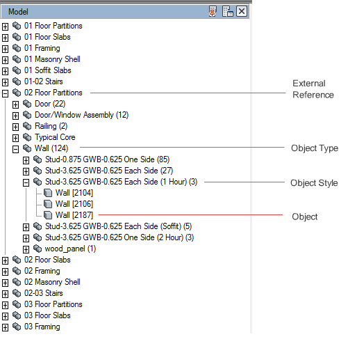

  • Grouping property set data by external reference first, and then by object type and object style:

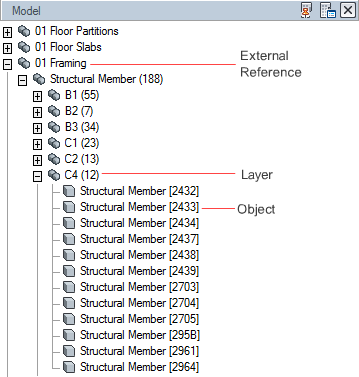

  • Grouping property set data by external reference first, and then by layer:

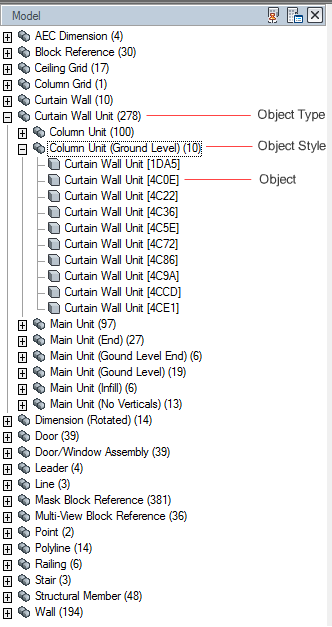

  • Grouping property set data by object type first, and then object style:

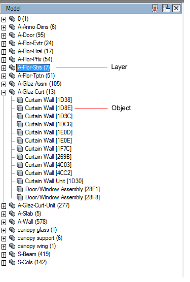

  • Grouping property set data by object layer:
