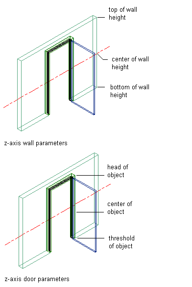

Door position along the Z axis parameters

  3. Select the reference point for the anchor along the Z axis:
    If you want to… Then…
    use the bottom of the wall height as your reference point select Bottom of wall (curve) height for From.
    use the center of the wall height as your reference point select Center of wall (curve) height for From.
    use the top of the wall height as your reference point select Top of wall (curve) height for From.
  4. Enter the distance from the reference point at which to place the doors.
    Use a negative value to measure from endpoint to start point.
  5. Select the position of the doors to measure to:
    measure to the bottom of the doors select Threshold (Bottom) of object for To.
    measure to the center of the doors select Center of object for To.
    measure to the top of the doors select Head (Top) of object for To.
