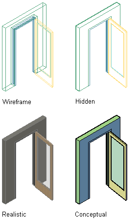

Doors in Wireframe, Hidden, Realistic, and Conceptual Visual Style representations
