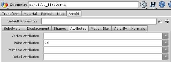

Under the attached Arnold properties is a tab called Attributes. Clicking the down arrow next to Point Attributes will list the available attributes on the fireworks, choose Cd. This will pass the attribute to the .ass file as User Data.

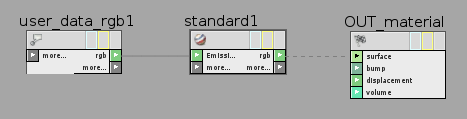

  • Now go the shop and into the fireworks vopnet. Create a User Data RGB shader and attach it to the Emission Color of the Standard Surface shader.
  • Select the *User Data RGB node and type Cd in Attribute.

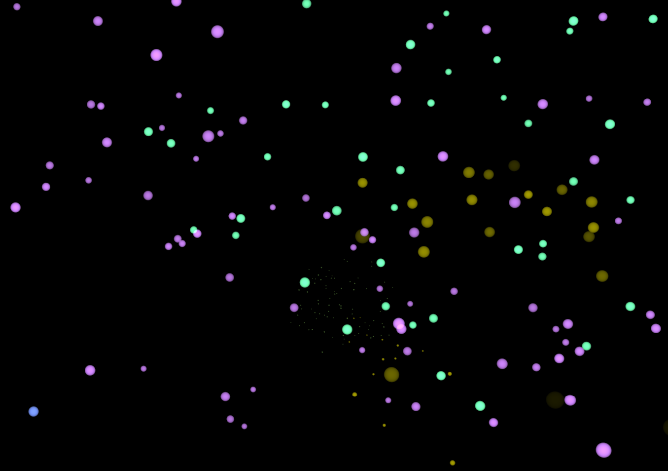

Now the disks should be rendered with color.

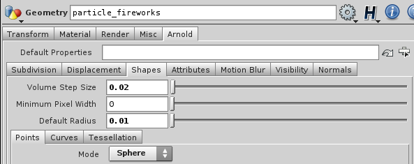

  • Select the fireworks and go to the Shapes properties again. To turn on volumes the volume Step Size needs to be increased to 0.02 and the Mode set to Sphere.
  • Now go the fireworks vopnet and delete the Standard Surface shader. Create a Standard Volume node instead. Attach it to the Volume parameter of the OUT_material. Connect the user_data_rgb1 to the emission of the Standard Volume.

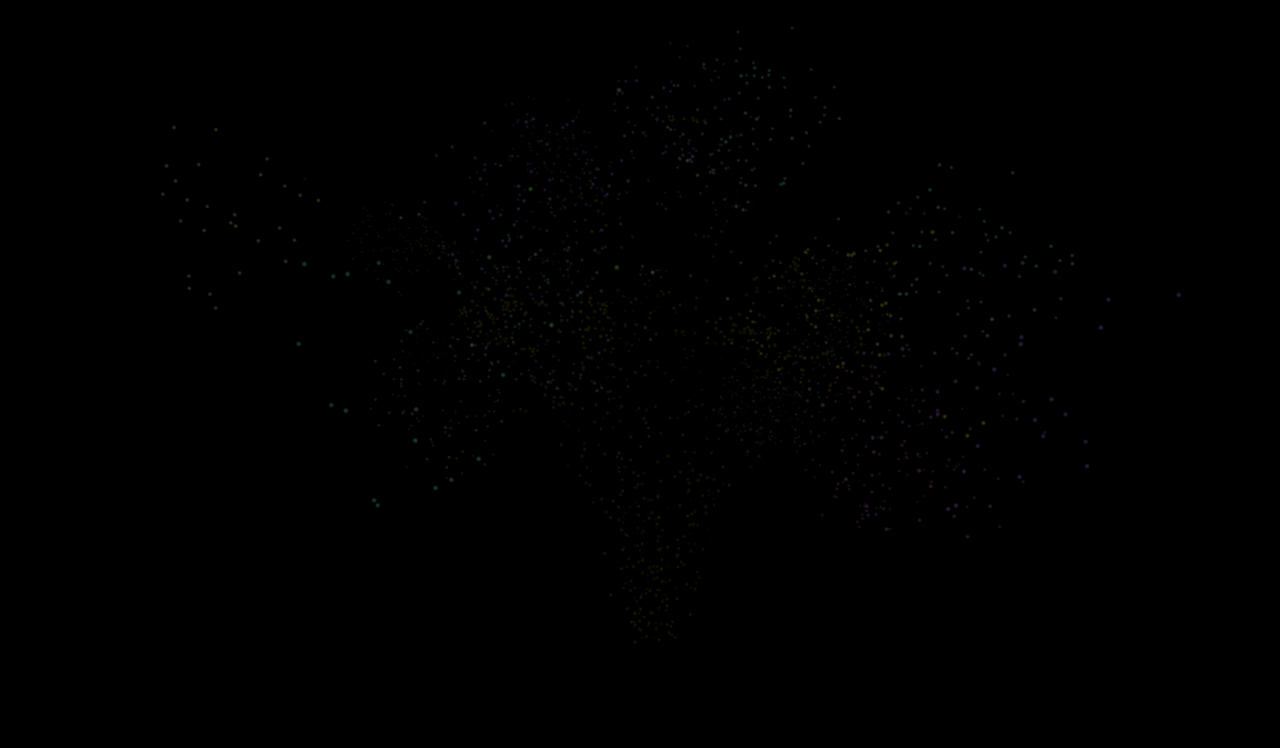

Render the scene again.

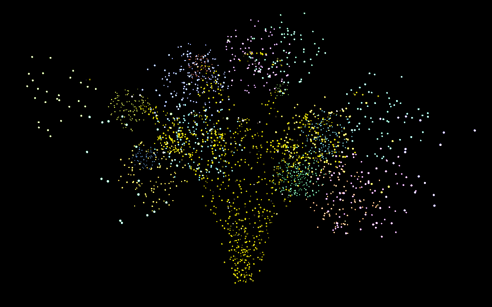

It is very dull because the values being passed to the Standard Volume are very low. Insert a Multiply shader and set Input2 to 40.
Close up, the volumetric nature of the spheres can be seen.
