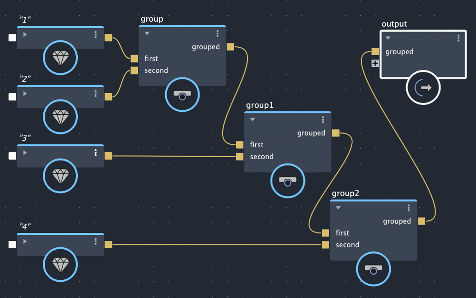

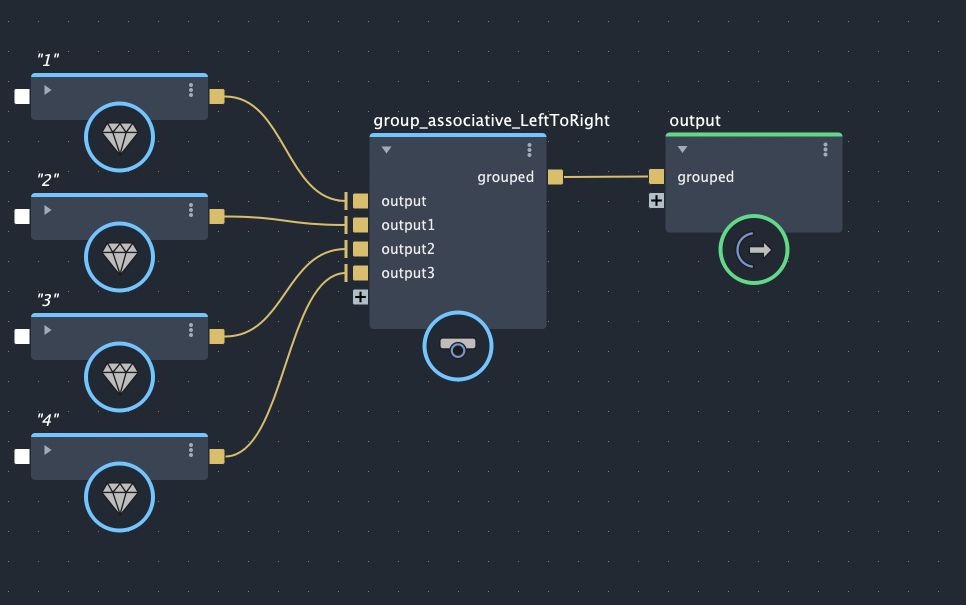

For example, the left-to-right associative node on the left is equivalent to the cascade of binary nodes on the right:
a left-to-right associative operator in a graph the conceptualization of the associative operator
The left-to-right associative node produces the same result as a cascade of binary nodes Both these graphs produce the same result: (((1+2)+3)+4)

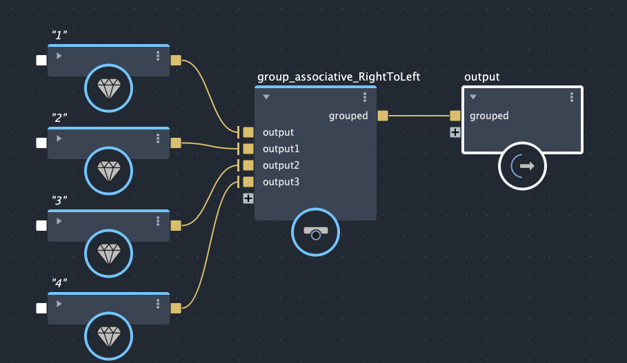

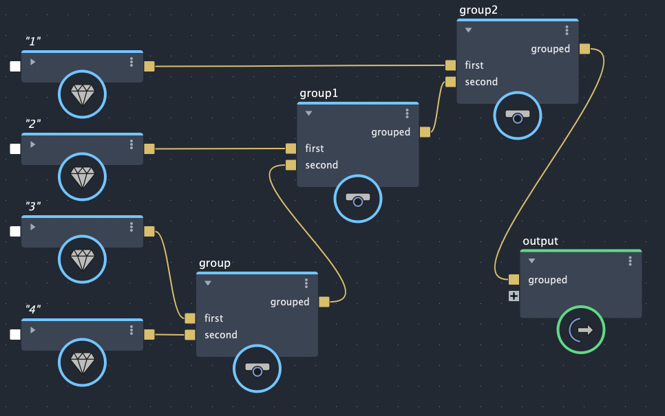

And the right-to-left associative node on the left is equivalent to the cascade of binary nodes on the right:
a right-to-left associative operator in a graph the conceptualization of the associative operator
This right-to-left associative node produces the same result as a cascade of binary nodes Both these graphs produce the same result: (1+(2+(3+4)))
