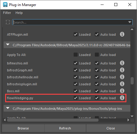

  1. Make sure that you are running Maya 2025 with Bifrost 2.12.1.0, or later versions.
  2. Open Maya's Plug-in Manager: Windows > Settings/Preferences > Plug-in Manager.
  3. Make sure that flowWedging.py is loaded.
    `flowWedging.py` in Maya's Plug-in Manager
    If you'll be wedging often, you can set it to Auto load.

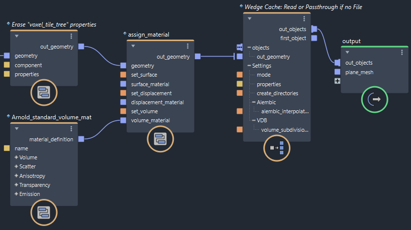

  3. Add a wedge_cache node to the top level of the graph, and connect the objects to be wedged into the objects port.
    wedge_cache node connected in the graph
    • The output of the wedge_cache node must eventually lead to an output node. Wedging does not work if it is connected only to terminal nodes.
    • It's usually best to assign a material before the wedge_cache node so that the material will be included in the caches (as well as preview renders if you generate them). The exception is when you plan to use the VDB format for caches — the VDB format does not support material assignment, so assign the material after wedge_cache to ensure that the material is properly applied after the cache files have been read.
    • Use only one wedge_cache node per graph. Flow Wedging will process only the first node it finds in the graph that's selected for a job. However, you can connect multiple objects to the objects fan-in port of the wedge_cache node to process several objects as an array.
    • By default, the wedge_cache node's mode is set to Read or Passthrough if no File. In this mode, it will automatically read the cache files once they exist later in this procedure. However since you have not downloaded any cache files yet, it instead evaluates the upstream nodes and simply passes the result along to the downstream nodes.

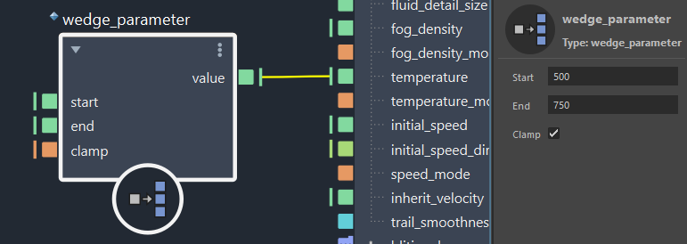

  4. Connect a wedge_parameter node into an input that you want to vary, and set the start and end values for the range you want to test. The wedges will be evenly spaced between these values based on the number of wedges that you specify in a later step. For example, if you have only one wedge then it will be evaluated at the midpoint between start and end; two wedges will be evaluated exactly at start and end; three wedges will be evaluated at start, the midpoint, and end; and four wedges will be evaluated at start, 1/3 of the range, 2/3 of the range, and end.
    wedge_parameter node connected to an input
    • By default, start and end are auto ports that are set to float type. To vary something else such as vector3, right-click on either port and select a different value type.
    • You can use multiple wedge_parameter nodes to vary multiple inputs. However, they will not be varied independently — instead the parameters will be varied in lock-step between their respective start and end values based on the wedge being evaluated.
    • If you do not use any wedge_parameter nodes, you can still submit a job. This may be useful if you simply want to offload the generation of cache files to the cloud without any wedging.
    • As an alternative to wedge_parameter, you can use wedge_index to return the index of the wedge being evaluated (0, 1, 2, etc.) and use custom logic to specify the input value for each case.

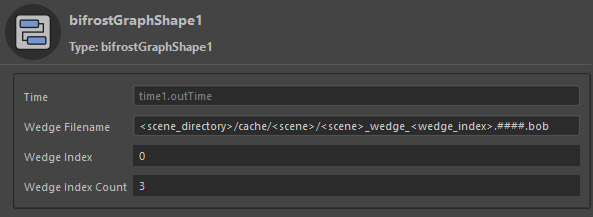

  5. At the top level of the graph, deselect all nodes. The global variables of the graph appear in the Parameter Editor. Set the Wedge values as desired.
    Global variables
    • Wedge Filename is the full path and file name for downloading the caches. A path without tokens is valid for a single cache, but keep in mind that the <wedge_index> token should be used to ensure that different wedges do not overwrite each other's files. Environment variables of the form $variable or ${variable} can be used, and will be expanded after takens are replaced. The extension determines the format of the cache files: .bob for Bifrost object files (any objects), .abc for Alembic files (meshes, particles, strands), or .vdb for VDB files (volume). Any other extension will be written as Bifrost object files.
    • Wedge Index specifies which set of cache files to read once they have been downloaded. It can also be used to specify which wedge to evaluate if you choose not to evaluate all wedges in a single job.
    • Wedge Index Count sets the total number of wedges that you want to evaluate. It is also used to calculate the fraction of the range between the wedge_parameter nodes' start and end values. The maximum number of wedges per job is 4.

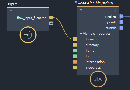

If the graph depends on external files, you must make sure they are included when the graph is uploaded for wedging. This includes image files used for textures and geometry files such as USD or Alembic used for emitters and colliders, as well as others.
To include such files:
  1. Connect the filename port of a file node to an input node at the top level of the graph.
    • This creates a corresponding input parameter in the Graph Inputs section of the bifrostGraphShape node in the scene.
    • The current path is automatically copied over to the input parameter.
    • If necessary, you can modify the path in Maya's Attribute Editor.
  2. Rename the port on the input node to flow_input_filename. This also renames the corresponding parameter of the bifrostGraphShape node in Maya.
  3. Repeat for any additional files. Subsequent ports will have an integer appended automatically (flow_input_filename1, flow_input_filename2, etc.), and the files associated with those ports will be included when you submit a job.
Including an external file for wedging

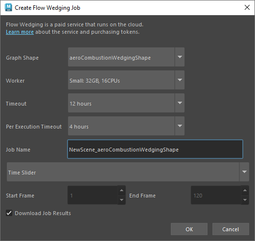

  1. Choose Flow > Flow Wedging > Create New Job from Maya's main menu. After you sign in to your account if required, the Flow Job Monitor window launches and the Create Flow Wedging Job dialog box opens:
  2. Set the options as desired:
    • If the scene has multiple graphs with wedge_cache nodes, make sure to set Graph Shape to the one that you want to evaluate for this job.
    • Set Wedge to evaluate the current wedge only (Wedge Index in the job parameters at the top of the graph), or all wedges.
    • Select a Worker based on the size and complexity of your scene.
    • Set Timeout and Per Execution Timeout to prevent excessive computation and token use in case there is a problem with your scene or its settings.
    • Job Name is used only to identify the job in the Flow Job Monitor. The default name is based on the names of the scene and graph.
    • Select the range of frames to cache: Time Slider for the entire scene length, Animation Range for the current playback range, or Custom to specify Start Frame and End Frame manually. However, note that simulations must start from the first frame.
    • If you set up preview rendering, set those options as well.

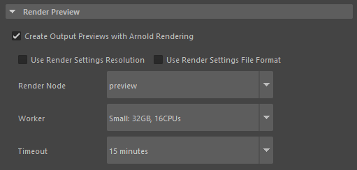

  3. If you set up preview rendering, set those options as well.
    Render preview options
    • Turn off Create Output Previews with Arnold Rendering if you want to skip generating previews for this job.
    • Select Use Render Settings Resolution and Use Render Settings File Format to use the image resolution and format set in the scene's render settings instead of the default (250 × 250 pixel PNG files).
    • Select Worker and Timeout as above.
    Note: Render Node is not implemented.

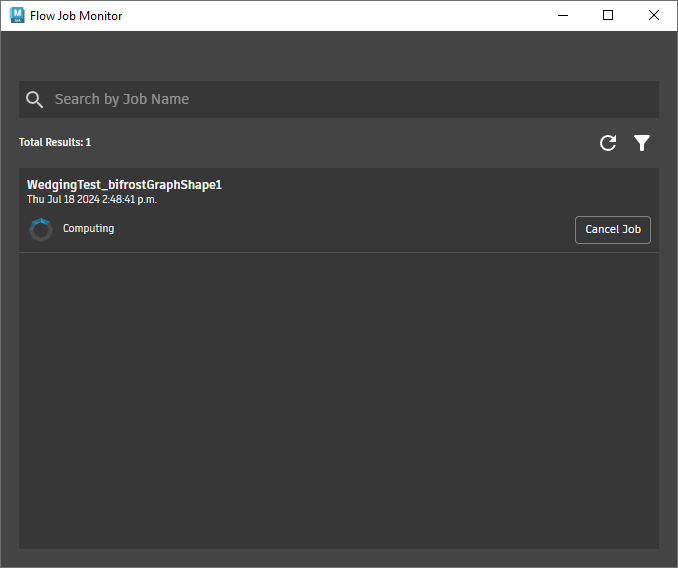

  4. Click OK. The graph and any connected scene objects are uploaded to the Flow Wedging service and the Flow Job Monitor shows progress.
    Flow Job Monitor showing progress
    If you receive the errors shown below, it means that you are running unsupported versions of Bifrost or Maya. Ideally, you should use the latest versions, or at least Maya 2025 with Bifrost 2.12.1.0.
    Error 400 Submission error

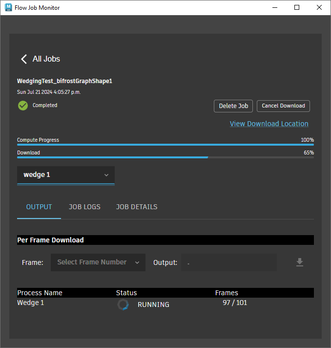

  5. You can close the Flow Job Monitor while the job gets computed in the background, and then choose Flow > Flow Wedging > Open Job Monitor to re-open it at any time to monitor progress. Click on a specific job to view details, log files, play through preview renders, and more.
    Details of a job
Progress logs are saved to a local file by default to declutter the script editor as the plug-in uploads and downloads files. These are not the same as the job logs that you can download later, which contain information about the job execution in the cloud. The names and locations of these progress logs are based on the version of Maya, the date, and a unique process ID. Each running instance of Maya has its own log file. Here are some sample paths:
  • Windows: %LOCALAPPDATA%\Autodesk\FlowGraphEngine\maya2026\2025-08-15\FlowWedging_20250815T224436Z_28248.log
  • Linux: ~/.local/share/Autodesk/FlowGraphEngine/maya2026/2025-08-15/FlowWedging_20250815T224436Z_28248.log
  • MacOS: ~/Library/Logs/Autodesk/FlowGraphEngine/maya2026/2025-08-15/FlowWedging_20250815T224436Z_28248.log
Folders older than 30 days are deleted in the background.

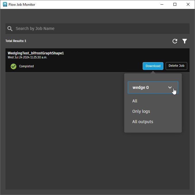

  1. Open the Flow Job Monitor.
  2. Locate the job to download, and click Download.
    Download files
  3. Select a wedge, if there are multiple wedges in the job.
  4. Select the items to download (for example, All or Only logs).
  5. Browse and select a folder on your disk for the downloaded files. You do not need to select the Wedge Filename location that was set on the wedge_cache node, but note that the graph will not read the downloaded cache files until you update that parameter with the new location.

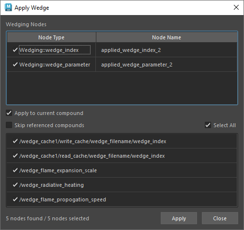

  4. Choose Edit > Apply Wedge. A list of nodes that will be affected is displayed.
    Apply Wedge dialog box
  5. Set the options as desired:
    • The upper box shows the node types that will be affected, as well as a tag that will be be used to rename the affected nodes. If you want to lock the settings of only wedge_parameter nodes then you can deselect wedge_index, and vice versa.
    • Apply to current compound restricts the scope to the compound you navigated into in step 3, if applicable. If you are at the top level of the graph, it has no effect.
    • Select Skip referenced compounds to preserve nodes that are inside referenced compounds like wedge_cache. If you don't do this, then you'll need to use a new wedge_cache node if you want to continue using the same graph for further wedging.
    • Deselect any individual nodes that you want to preserve in the lower box, or choose Select All.
  6. Click Apply.
