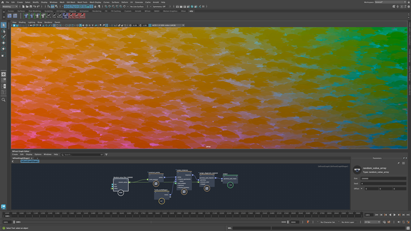

Per-instance colors on a cloud of turtles
Viewport speed and feature improvements for instances. Instances can be colored by the point_color property.

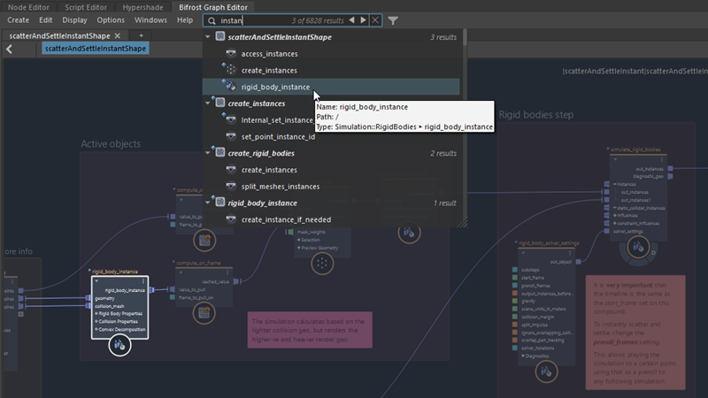

Searching for nodes in the graph
The new search box in the Bifrost Graph Editor lets you easily find where specific nodes are used. The search finds strings in both node names and node types, and supports regular expressions (regex). Select a node in the list of matches to automatically frame and highlight it. See Find a node in the graph.
