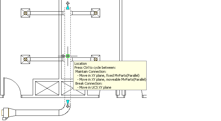

You can move duct segments, duct fittings, and HVAC MvParts using Location grips, as shown next.
Example of a Location grip for a duct segment.

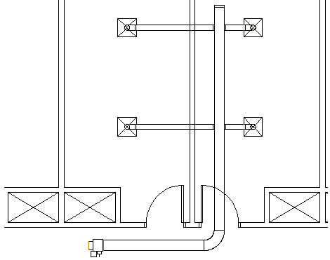

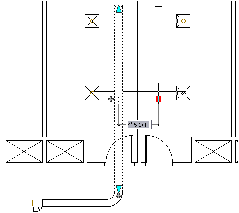

If the object is connected to a system, you can move connected objects in the current XY plane to maintain connectivity. The following illustrations show how location grips are used to move duct objects.
Top view of a duct run

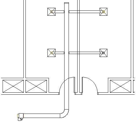

Location grip used to move the duct branch to the adjacent room.
Duct branch moved to the new location
