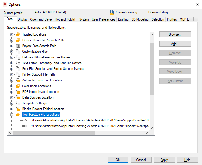

The tool palette set is the collection of tool palettes specified for the current profile in the Tool Palettes File Locations setting.
- Click
. - In the Options dialog box, click the Files tab.
