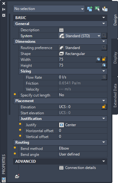

Add the basic properties of a duct using the properties palette.
By default, Basic properties are displayed in the Duct Properties palette.

General Action Selections
Description
Describes the duct part (optional).
System
Selects a system definition for the duct object in the current drawing.
Standard (default); selections derived from the catalog

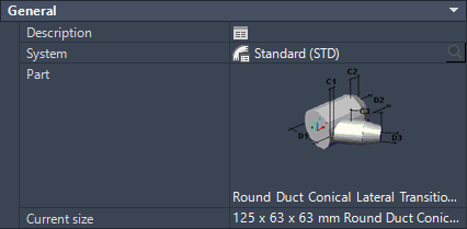

***Part
Click the image next to part to open the Select a Part dialog box.
***Current Size
Choose one of the sizes proposed in the drop-down menu. All sizes are standardized.
General User Interface for Duct fittings
Dimensions Action Selections
Routing preference Selects a routing preference for the duct object in the current drawing. Standard (default); selections derived from the catalog
Shape Specifies the shape for the selected object. Rectangular (default); thereafter last used shape
Size Selects a size within the range specified in the current routing preference. There are different default size parameters, depending on the selected shape.
  • Oval - Width and Height
  • Rectangular - Width and Height
  • Round - Diameter
Last used value selected
Calculate Size Calculates the sizes of the duct based on the Flow Rate, Friction, Roughness and Density. If a rectangular or oval shape is selected, one size has to be fixed to calculate the other one.
Note: For more information, see Duct Size Calculator.
Size lock
Prevents the size value from being changed.
  • Unlocked (default)
  • Locked
***Connections Customize the sizes of the fitting you want to add.
*Flow Rate Flow Rate is read from MvParts that are connected to the Duct Run or can be entered. 0 (default). Flow Rate will be automatically refreshed if the Duct is connected to a MvPart.
*Friction Shows the value for friction of the selected object based on the definition in the Duct System Definitions section in the Style Manager (Read-only).
*Velocity Shows the value for velocity of the selected object based on the definition in the Duct System Definitions section in the Style Manager (Read-only).
Cut Length
If Yes is specified, then Cut Length lets you specify a dimension. Selecting No hides the Cut Length property.
No (default)
Placement Action Selections
Elevation
Specifies a Z value (elevation) above or below the XY plane of the current user coordinate system (UCS).
0 (default), thereafter last used elevation
Elevation lock
Prevents objects of one elevation from snapping to objects of another elevation.
  • Locked
Start elevation
Specifies an elevation for connector 1 on the duct object. Start elevation is the same value as Elevation.
0 (default)
Justification Action Selections
Justify
Orientates the justification of the duct object.
  • Top Left
  • Top Center
  • Top Right
  • Center (default)
  • Center Left
  • Center Right
  • Bottom Left
  • Bottom Center
  • Bottom Right
Horizontal offset
Specifies a placement offset in the horizontal direction from the insertion point.
0 (default); thereafter last used value
Vertical offset
Specifies a placement offset in the vertical direction from the insertion point.
Routing Action Selections
*Bend method
Select the desired Bend method. Choose either Elbow, Offset or Transition Offset.
  • Elbow (default)
  • Offset
  • Transition - Offset
*Bend method lock
Prevents the bend method from being changed. If you do not lock the offset or transition - offset bend method, then the setting reverts to elbow after one instance of the selected bend method is inserted in the duct run.
Note: Appears only if the offset or transition - offset is chosen.
  • Locked
*Bend angle
Specifies the angle to constrain the routing in the duct run.
The bend angle varies, depending on the values that are defined in the catalog content.
*Bend angle lock
Prevents the bend angle from being changed. The Bend angle lock button appears only for user defined angles.
  • Locked
**Segment
Specifies the layout method for the flexible duct.
  • Line
  • Arc
  • Spline
**Radius factor
If Line is selected for Segment, radius factor lets you specify a radius value.
*Branch fitting
Specifies the way to connect ducts.
  • Takeoff
  • Tee
