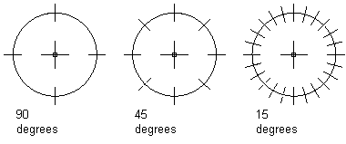

Examples of Compass tick mark increment settings
For most drafting tasks, it is useful to assign tick marks based on the specified snap increment. For example, if the snap increment is at 45 degrees, then assign tick marks to appear at 45 or 90 degrees. However, if the snap increment is less than 45 degrees, such as 15 degrees, assign the tick marks to appear at 30, 45, or 90 degrees to avoid a cluttered Compass display.

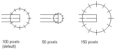

You can also change the color and size of the Compass display to enhance the visibility of the Compass as it overlaps and aligns with objects in your drawing. The Compass size is expressed in pixels and remains constant regardless of the zoom scale factor you apply to a drawing.
Compass diameter changes
