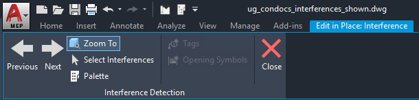

to start the analysis. When the analysis is completed, locate the Edit in Place tab on the ribbon to view the Interference Detection panel.
