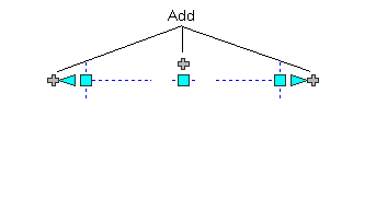

Using add grips provides an efficient way to quickly begin drawing a plumbing line. It ensures connectivity between the object and plumbing line.
Add grips on a plumbing line segment
