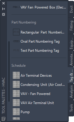

Locate the part number tag and schedule tools on the Tags and Schedules palette.
The Tags and Schedules Tool Palette
The part number tools let you number tags individually or in a sequence, and allow using the same number for parts of the same type. Part number tags can use either numbers or text labels. While part number tags work with any MEP object, the Tags and Schedules palette provides scheduling tools only for duct and piping systems. For more information, see Working with Part Number Tags and Schedules.
