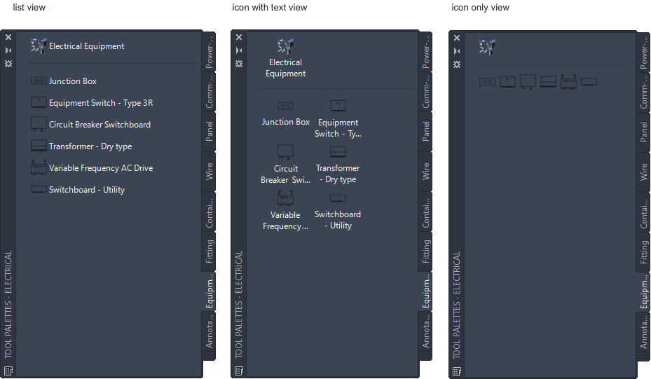

The same tool palette with three different views

To modify the appearance of one or more tool palettes
  1. If you want to modify the appearance of only a single tool palette, open that palette.
  2. Right-click the palette that is currently open, and click View Options.
  3. Drag the Image size slider to the left to decrease the size for tool images or to the right to increase it.
  4. Select an appearance:
    If you want to view… then select…
    tool images only Icon only for View style.
    tool images and names Icon with text for View style.
    tool images and names in a single-column list List view for View style.
  5. Select the scope for the changes:
    If you want to apply the changes to… then select…
    the current palette only Current Palette for Apply to.
    all palettes in the tool palette set All Palettes for Apply to.
