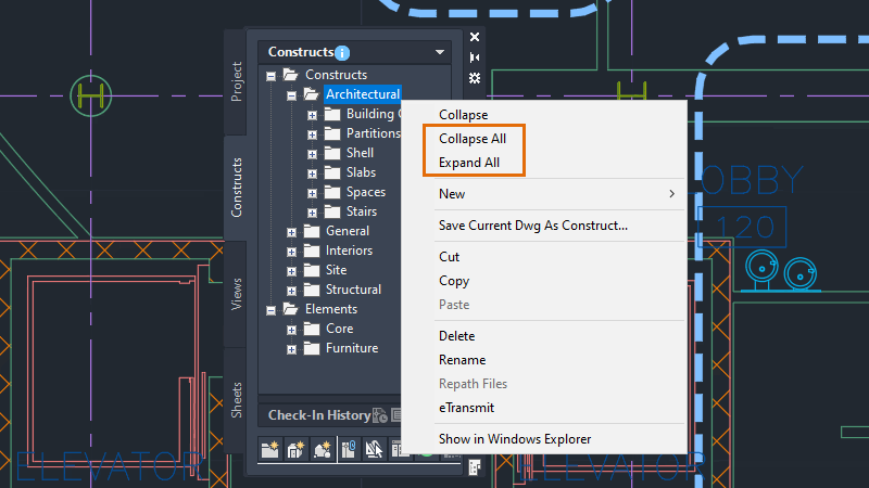

  • Working with inaccessible paths in Project Navigator

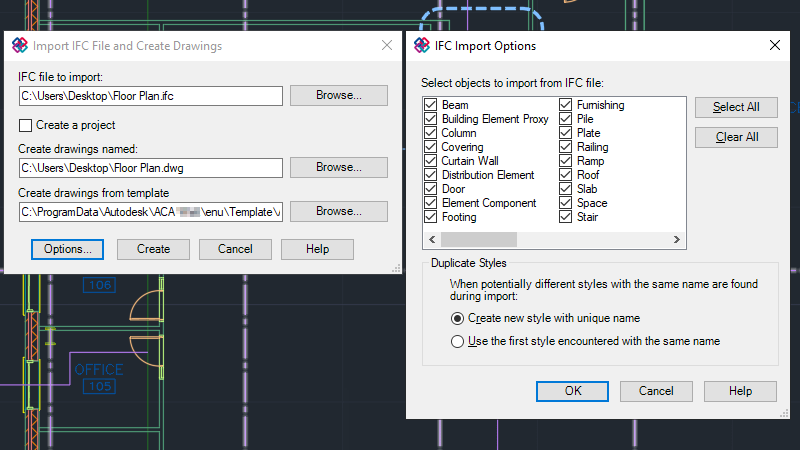

IFC Import: Truncated file paths now successfully import.
IFC Export: Consecutive exports now maintain the correct IFC structure. System errors during some IFC exports are also fixed.
