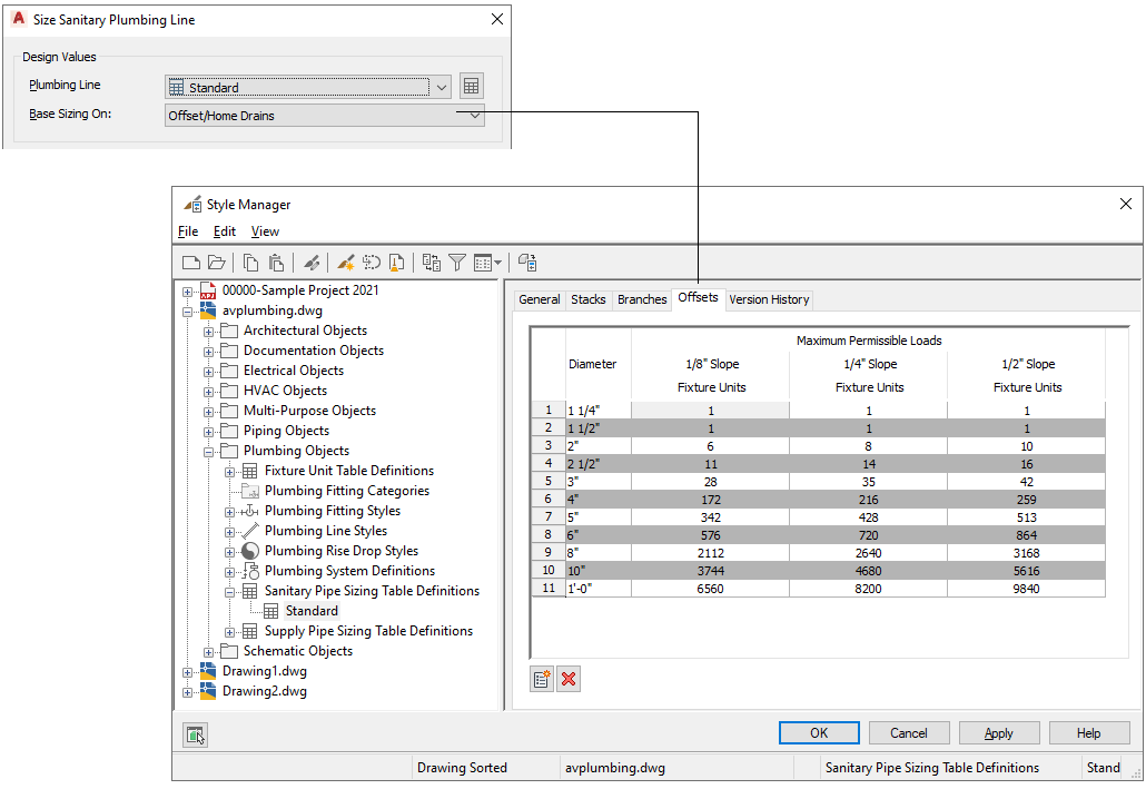

When you define the sanitary run as an offset or a home drain, the plumbing module performs the sizing calculations using the information on the Offsets tab in the sanitary plumbing line sizing table (pipe sizing table), whose definitions can be found in Style Manager.
