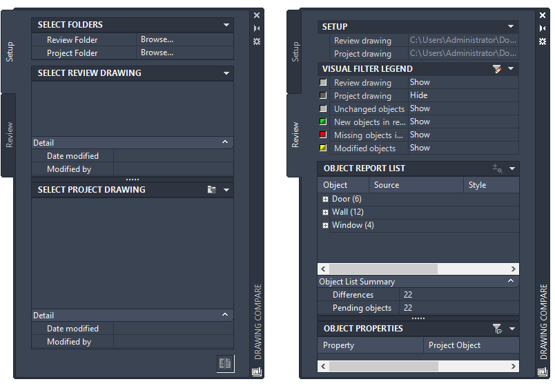

You select the review drawings and compare each to its corresponding project drawing on the Setup tab of the Drawing Compare palette. After the comparison, you view the results on the Review tab of the Drawing Compare palette and in the drawing area.

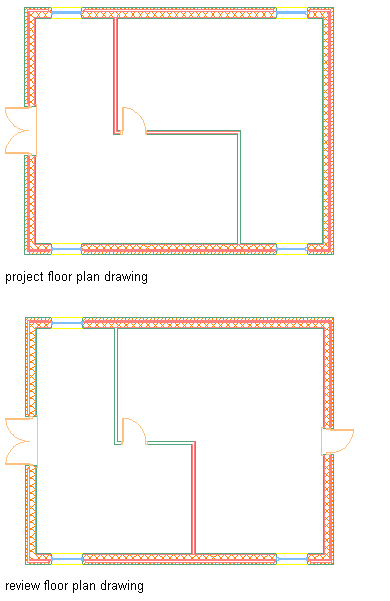

In the following example, a simple floor plan was modified to show what information Drawing Compare displays during a comparison session. The review drawing shows that changes to the project drawing include moving the lower vertical interior wall segment to the left (resulting in a shorter horizontal interior wall segment), adding an exterior door to the right exterior wall segment, and removing a window from the upper exterior wall segment.

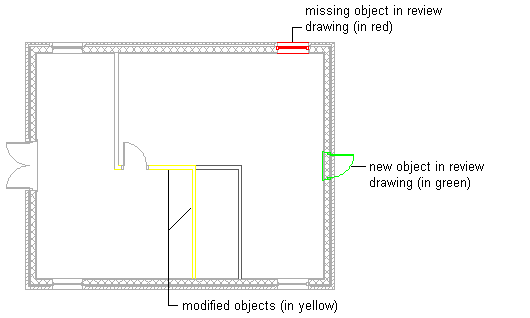

When the drawings are compared, color-coded changes are displayed, based on the type of change.

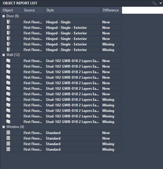

Information about changes is also displayed in the Object Report List on the Review tab.
