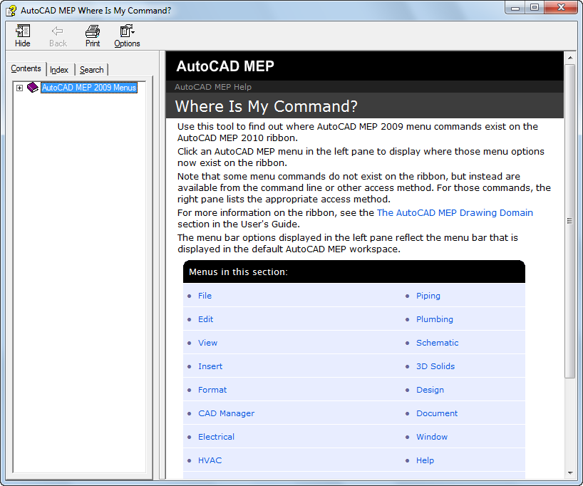

Where is My Command? Tool
The Where is my command? tool is a help file that lists all commands by their previous menu location and displays their current location on the ribbon.
Where is My Command? tool
You can access the Where is my Command? tool from the Help menu ![]()
Where is my Command, or from the landing page of the regular Online Help.

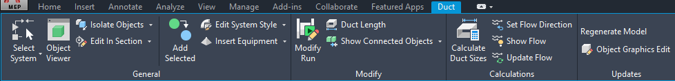

Context Menu
Commands that refer to a selected object appear on the contextual tab for that object. Commands disappear from the ribbon after the object is deselected.
Duct context tab
The command layout of the contextual tab of an object is in most cases based on the structure of commands on the context menu of the object.
Duct context menu
For example, on the context menu of a duct you can find the Add Selected command. On the contextual Duct tab, you can find the Add Selected command on the General panel.
