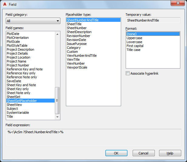

- Define the first attribute for the callout tool.
- Enter a name in the Tag field.
- Under Value, click
- Under Field category, select the desired category. Tip: The Sheet Set category contains fields for views and sheets.
- Under Field names, select the field you want to insert.
Some fields require additional information, like a file name or property information.
- Select the text format for the field text.
- Click OK.
- Add the attribute. Note: An attribute can contain only one sheet set field. If you want to create a callout line that reads, for example, View Number - View Title, you must define two separate attributes.
