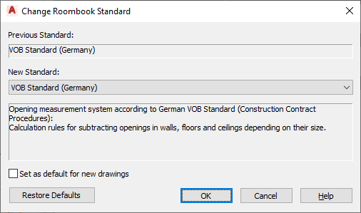

  1. Click Vision Tools tab Roombook panel Calculation Settings.
    The current standard is displayed.
  2. Click Change.
  3. Select another standard, and confirm or cancel the alert of resetting all previous calculations and manual adjustments.
Now, the defined calculation standard is set current and will be used for the next room quantity calculation.
Previous Standard
Shows the name of the standard which was used until now.
New Standard
From this selection list you can select the standard to which you want to switch.
Set as Default for New Drawings
If you checkmark this option, then the "New Standard" will be used as default for all new drawings. Existing drawings will keep their standard.
Restore Defaults
This button resets the previous standard, if you have selected another standard from the list.

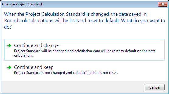

Do you want to continue
The alert displays when you leave the dialog box with OK.
Yes
Continue with Yes, when you are sure that you really want to change the standard. You are aware that this will reset all previously made Roombook calculations and all manual adjustments.
No
Cancel with No, when you do not want to change the standard, but want to keep the previous. All previously done Roombook calculations and manual adjustments remain unchanged.
