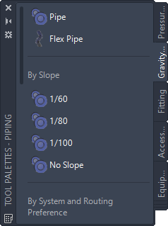

You can display the tool palette set while retaining a view to the drawing underneath by applying transparency to the tool palette set.
Tool palette set with transparency
