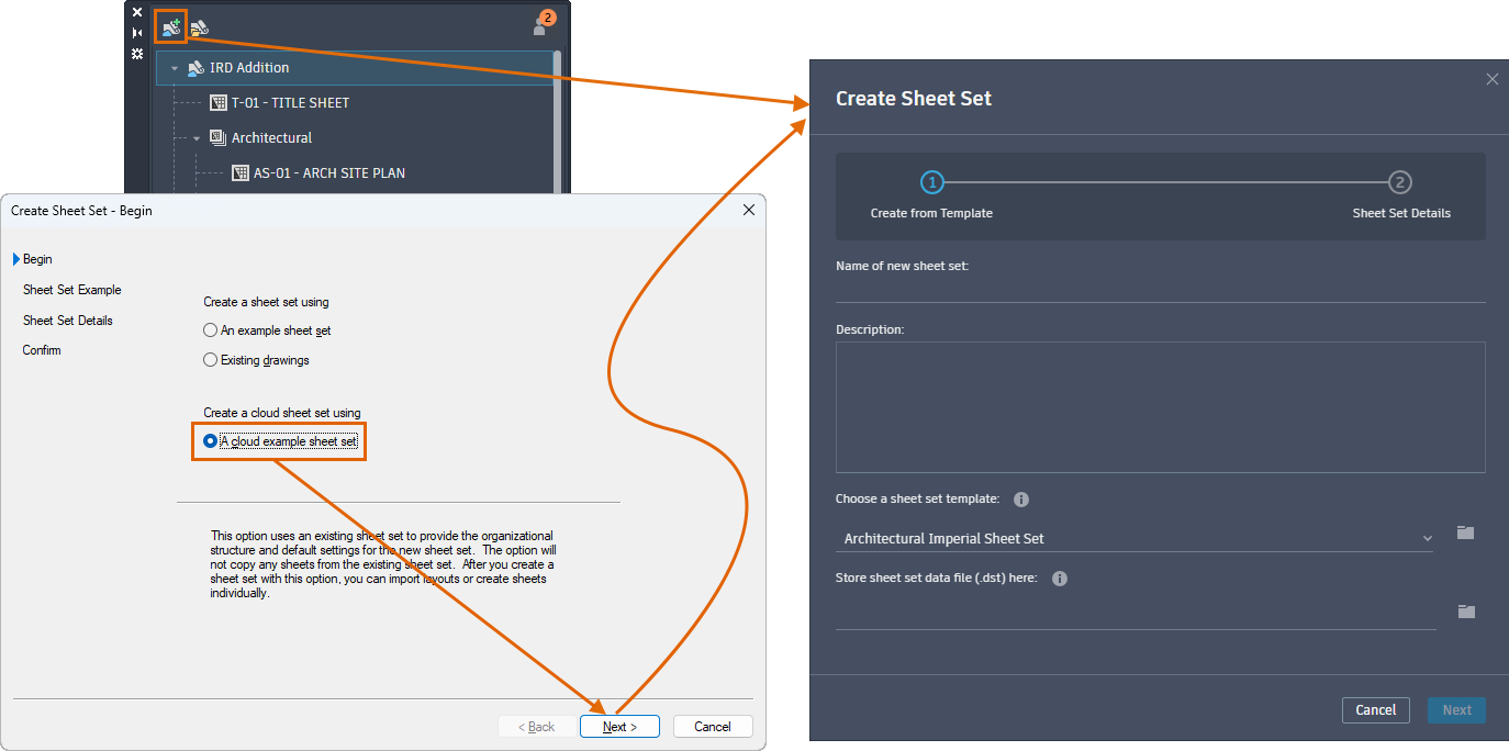

Create a Sheet Set in the Cloud
Use the following steps to create a sheet set for use in cloud.
  1. In AutoCAD desktop, click Application menu NewSheet Set. Find
    In the AutoCAD web app, click (Create Sheet Set) on the Sheet Set Manager.
  2. Follow the steps in the Create Sheet Set wizard.
  3. Choose the option to create a cloud sheet set using an example sheet set.
  4. Click Next.
  5. In the Create Sheet Set dialog box, enter the name, description, and location of the new sheet set.
  6. Choose a sheet set template.
  7. Click Next.
  8. Review the sheet set properties and click Create.

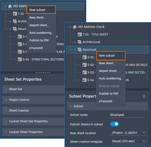

Create a New Sheet Set Subset
  1. In the Sheet Set Manager for Web, right-click the sheet set node (at the top of the list), or an existing subset node. Choose New subset.
  2. Select the new subset, if necessary.
  3. At the bottom of the Sheet Set Manager for Web, Subset Properties, enter the name and other properties of the new subset.

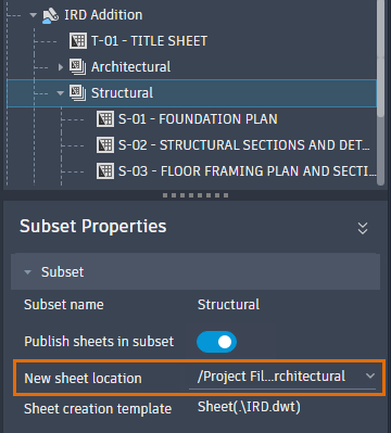

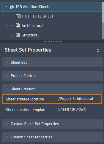

Specify a Location for New Sheets
  1. In the Sheet Set Manager for Web, select a sheet set or a subset.
  2. At the bottom of the Sheet Set Manager for Web, Sheet Set Properties pane, expand Sheet Creation and click Sheet Storage Location drop-down.
    If you've selected a subset, under Subset Properties pane, expand Subset and click New Sheet Location drop-down.
  3. Click Browse.
  4. In the Specify sheet storage location dialog box, click the appropriate checkbox to choose a folder.
    Important: When selecting a sheet location folder, do NOT click the folder name. Clicking the folder name displays the contents in the folder but does not select it.
  5. Click Select.

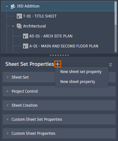

Add Custom Properties
  1. In the Sheet Set Manager for Web, select a sheet set.
  2. At the bottom of the Sheet Set Manager for Web, at the right of the Sheet Set Properties pane, click to create a new sheet set or sheet property.
    • Sheet set properties are typically specific to a project, for example, the contract number.
    • Sheet properties are typically specific to each sheet, for example, the name of the designer.
  3. To remove a custom property, right-click a property and choose Remove.

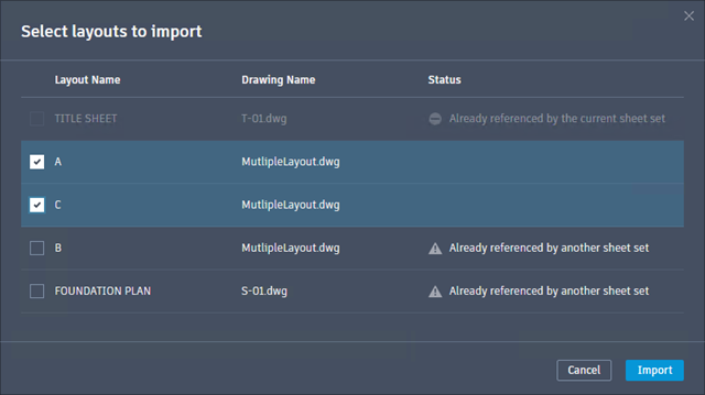

Import a Layout to a Sheet Set
Note: You cannot import sheets from locked drawings.
  1. In the Sheet Set Manager for Web, right-click a sheet set or a subset.
  2. Choose Import sheet.
  3. Browse to the cloud location and select one or more drawings that you want to use.
  4. Click Select.
  5. Select the layouts to be imported as sheets in the current sheet set or subset.
  6. Click Import.

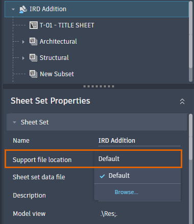

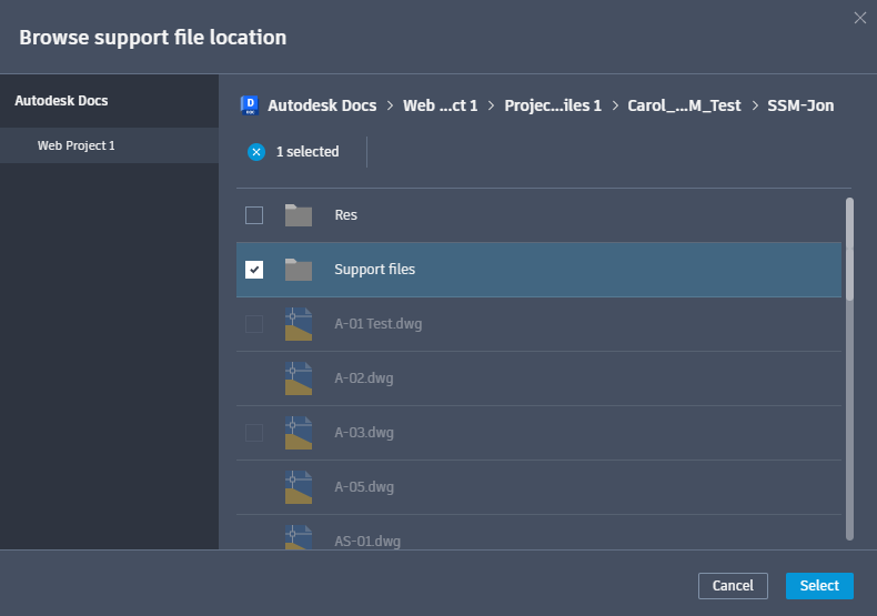

Specify a Support File Location
  2. At the bottom of the Sheet Set Manager for Web, Sheet Set Properties pane, expand Sheet Set and click Support File Location drop-down.
    Note: By default, cloud sheet sets use the support files such as drawing templates, plot styles, and fonts (.shx and .ttf) stored in the AutoCAD web app. For more information about uploading and managing support files, see the File Management topic in the AutoCAD web app Help.
  3. Click Browse.
  4. In the Browse to a support file location dialog box, choose a folder.
    Important: When selecting a support file folder, do NOT click the folder name. Clicking the folder name displays the contents in the folder but does not select it.
  5. Click Select.

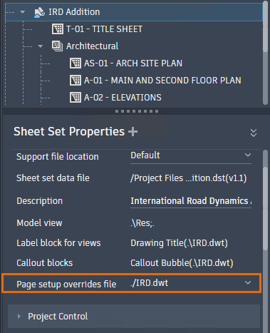

Specify a Page Setup Overrides File
When you publish a sheet set, you can use the page setups defined in each drawing file or you can apply the page setup overrides to all drawing files.
  2. At the bottom of the Sheet Set Manager for Web, Sheet Set Properties pane, expand Sheet Set and click Page Setup Overrides File drop-down list.
    Note: The drop-down list displays the drawing template (DWT) files that are stored in the configured support files folder for the cloud sheet set.
  3. From the drop-down list, choose a DWT file. If the desired file is not available, click Browse to explore folders outside the support files folder.
  4. In the Specify page setup overrides file dialog box, browse to the drawing template (DWT) file containing the page setup overrides.
  5. Click Select.

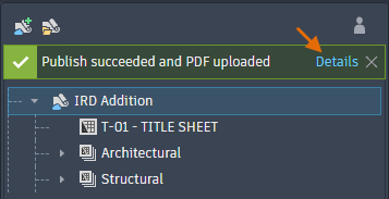

Publish to PDF
You can easily publish an entire sheet set, a subset of a sheet set, a single sheet.
  1. In the Sheet Set Manager for Web, right-click a sheet set, subset, or sheet.
    To publish multiple sheets, hold down the Ctrl key while selecting subsets or sheets, and then right-click.
  2. Choose Publish to PDF.
  3. In the Publish Settings dialog box, specify the following:
    • Output format. Defines how to publish the files. You can publish the sheets to a single multi-page PDF file or to multiple single-page PDF files.
    • File name. Specifies the name of the single multi-paged PDF file or the ZIP file name containing multiple PDF files.
    • Storage location. Specifies the folder where the PDF or ZIP file is created.
      Important: When selecting a storage location folder, do NOT click the folder name. Clicking the folder name displays the contents in the folder but does not select it.
    • Page setup overrides. Specifies the named page setup from the page setup overrides file to be used for the selected sheets.
  4. Specify whether to overwrite the file if a duplicate name exists in the specified storage location.
  5. Click Publish to start the publishing process.
    Keep an eye on any notifications that might display during the process.
  6. Once the publishing process is finished, on the notification, click Details to view information including any errors or warnings about the published job.
