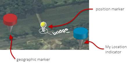

Geographic location information in a drawing file is built around an entity known as the geographic marker. The geographic marker points to a reference point in model space that corresponds to a location on the surface of the earth of known latitude and longitude. The program also captures the direction of the north at this location. Based on this information the program can derive the geographic coordinates of all other points in the drawing file.

After you insert a geographic marker in a drawing, you can:

- Use position markers to mark geographic locations and record related notes.
- Locate yourself on the map in real-time on systems that support location sensing.
