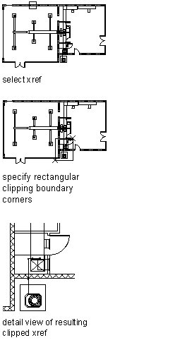

After attaching or overlaying an xref, you can define a clipping boundary to display only a portion of the xref.

To clip an xref
  1. Click Insert tab Reference panel Clip .
  2. Select a reference.
  3. At the prompt, select New Boundary by pressing Enter.
  4. Select a rectangular or polygonal clipping boundary, and then specify the corners or vertices of the boundary.
    The software clips the image based on the area that you specified, and hides the portion of the xref outside the clipping boundary.
Clipping an xref
Clipping an xref
