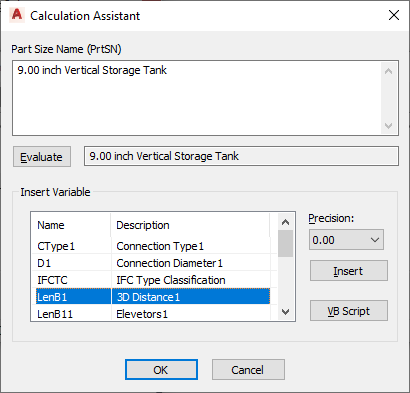

  6. To specify a unique part size name, in the Size Parameters dialog box, select Calculations from the list.
    The calculation strings are displayed.
  7. Double-click PrtD in row 1.
    The Calculation Assistant dialog box is displayed.
  8. In the Calculation Assistant dialog box, define the part size name.
    • Under Precision, select 0.
    • Under Insert Variable, select LenB1, and click Insert (to the right).
    • At the top of the dialog box, click the value for Part Size Name (PrtSN), and enter inch Vertical Storage Tank.
  9. Click Evaluate to see the result.
    Calculation Assistant dialog box showing values entered
