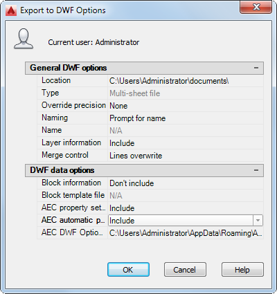

Use this procedure to include automatic and user-defined property set data in your PDF.
  1. Do either of the following:
    • Click Export DWF/PDF Options.
    • Enter exportsettings and select Options on the command line.
  2. In the Export to DWF/PDF Options dialog, under DWF data options for AEC property set data, select Include.
  3. Click OK.
Note: Data options are only available when you are publishing to DWF.
