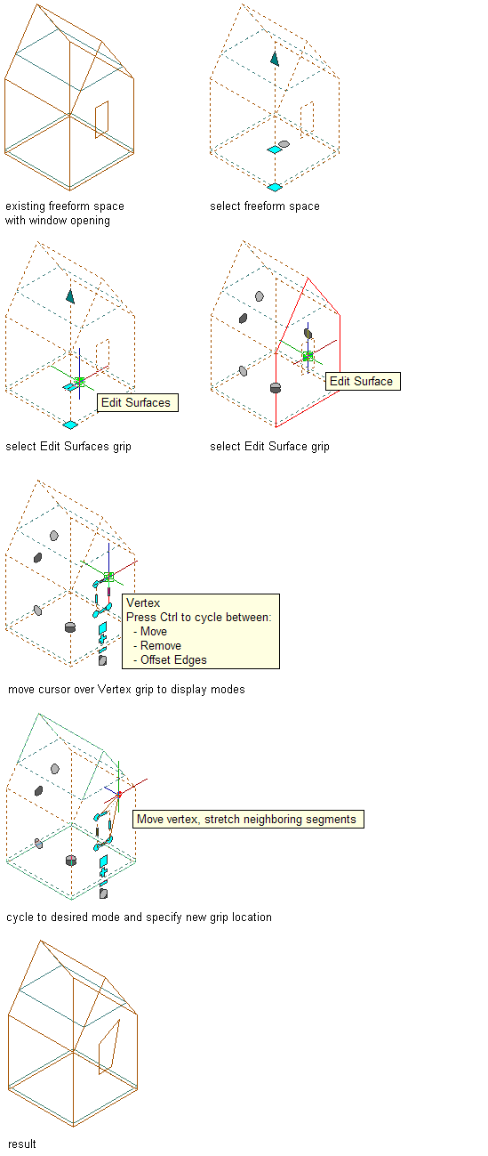

    • Move: This is the default. Use it to move the selected vertex in any direction. The neighboring segments are stretched if necessary.

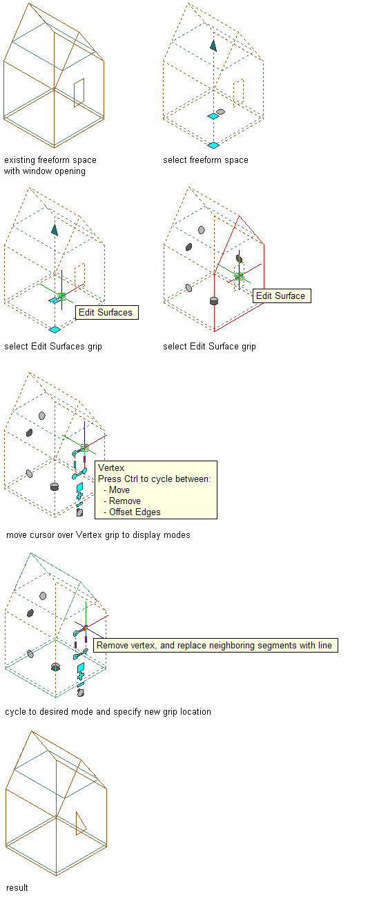

    • Remove: Use this edit mode to remove a vertex. The neighboring segments are replaced with a line.

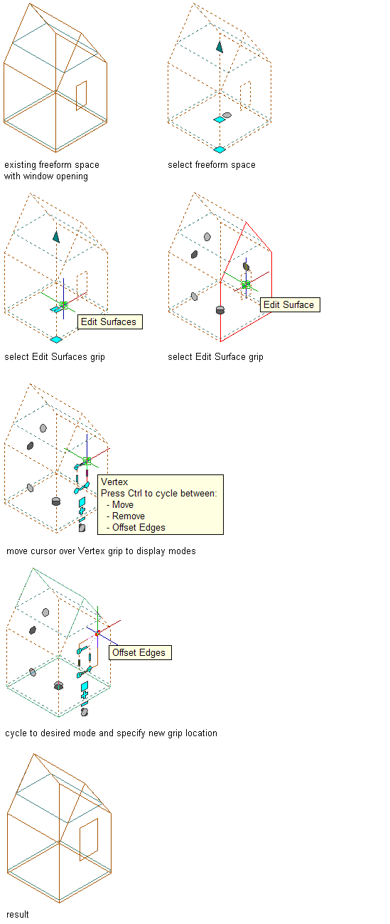

    • Offset Edges: Use this edit mode to move a vertex and the adjacent edges of the space boundary with it.
    Moving the vertex of a window opening on a freeform space surface
    Removing the vertex of a window opening on a freeform space surface
    Offsetting the edges of a window opening on a freeform space surface

    move the vertex move the vertex to the desired location, and click; or enter a value, and press Enter.
    remove the vertex press Ctrl to switch to the Remove Vertex edit mode, and click to confirm the removal.
    move the vertex and the adjacent edges press Ctrl twice to switch to the Offset Edges edit mode. Move the vertex to the desired location, and click; or enter a value, and press Enter.
