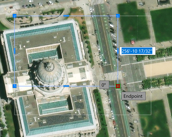

Grip Edit Behavior
Map images are bounded by a rectangular border. This border behaves like a layout viewport border. If you enlarge the map image by grip editing its border, the imagery does not resize. Instead, the border expands to display more of the map imagery.
If you rotate a map image by grip editing its border, it rotates and displays the underlying map imagery of the new area it covers. Similarly, if you move the map image by dragging the border, it moves and displays the underlying map imagery of that area.
Every time you grip edit a map image, it retrieves fresh imagery from online maps service to fill the new area covered by the border. Thus, you can edit map images only if you are signed in to your Autodesk account.
You can lock the layer containing a map image so that you cannot delete it, move it or resize it by accident.
Note: If you grip edit a map image while you are not connected to the Internet, the map image goes blank. As soon as you sign in to your Autodesk account, the map image retrieves fresh imagery from the online maps service.
