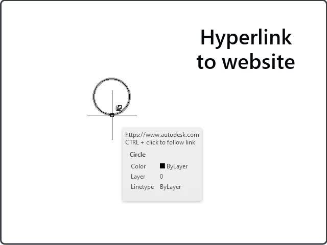

Add a Hyperlink to an Object
  1. Create a drawing and then create a circle.
  2. On the Insert tab, Data panel, click Hyperlink. Find
  3. Select the circle and press Enter.
    The Insert Hyperlink dialog box displays.
    Note: You can select several objects to which to add or edit hyperlinks. Each object remains separate and a hyperlink is added to each one.
  4. In the Insert Hyperlink dialog box, click Existing File or Web Page (1), enter Autodesk in the Text to Display field (2), and enter https://www.autodesk.com in the Type the File or Web Page field (3).
    Note: If you want to see the hyperlink destination before opening or editing the hyperlink, leave the 'Text to Display' field blank.
  5. Click OK.
Now, when you hover over the circle, you see the hyperlink cursor and tooltip. Ctrl+click on the object to open the hyperlink.
