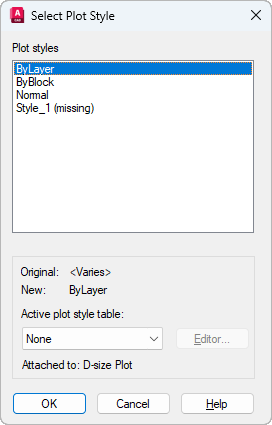

Select Plot Style Dialog Box
Specifies the plot style to be assigned.
PLOTSTYLE (Command) Find
List of Options
The following options are displayed.
Plot Styles
Displays the available plot styles, including the default plot style, NORMAL. A plot style is a collection of property settings used in plotting.
Original
Displays the originally assigned plot style.
New
Displays the new plot style to be assigned.
Active Plot Style Table
Sets the plot style table attached to the current drawing. A plot style table defines plot styles.
Editor
Displays the Plot Style Table Editor.
Attached To
Displays the tab (Model tab or layout tab) that the plot style table is attached to.
