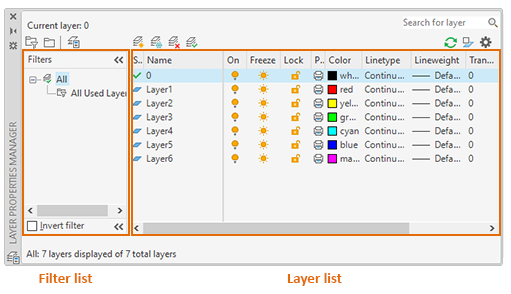

Layer List
Modify the layer properties using the layer list. Click the current setting to change the layer property for the selected layer or group of layers.

Filters List
Displays the list of layer filters in the drawing. Click
to expand or collapse the filter list. When the Filters list is collapsed, use the Layer Filter button (
) at the bottom-left corner of the Layer Properties Manager to display a list of filters.

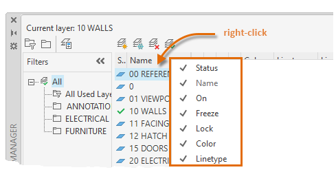

Column Label Shortcut Menu
- Column Names
Lists all columns by name. A check mark indicates that the column is included in the display. Click a column name to display or hide the column. VP Freeze, VP Color, VP Linetype, VP Lineweight, and VP Plot Style are available only when a layout viewport is active.
- Customize
Displays the Customize Layer Columns dialog box, where you can specify which columns are hidden or displayed, or change the column order.
- Maximize All Columns
Changes the width of all columns to fit the column headers and the data content.
- Maximize Column
Changes the width of the selected column to fit the column header and the data content of that column.
- Optimize all columns
Changes the width of all columns to fit the content in each column.
- Optimize column
Changes the width of the selected column to fit the content in that column.
- Freeze column (or Unfreeze column)
Freeze keeps the column, and any columns to the left, visible while scrolling. Unfreeze so that all columns scroll.
- Restore All Columns to Defaults
Sets all columns to their default display and width settings.

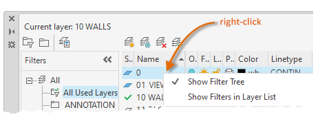

Layer List Shortcut Menu
- Show Filter Tree
Displays the Filters list. Clear this option to hide the list. Same as
- Show Filters in Layer List
Displays layer filters at the top of the layer list. Clear this option to display only layers in the layer list.

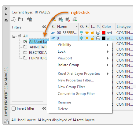

Filter List Shortcut Menu
- Visibility
Changes the visibility of the layers in the selected filters.
- Lock
Controls whether layers are locked or unlocked in the selected filters.
- Viewport
In the current layout viewport, controls the VP Freeze setting of the layers in the selected filters.
- Isolate Group
Freezes all layers that are not included in the selected filters.
All Viewports.
- In all layout viewports, sets VP Freeze for all layers that are not included in the selected filters.
- In model space, freezes all layers that are not in the selected filter, except for the current layer.
Active Viewport Only.
- In the current layout viewport, sets VP Freeze for all layers that are not included in the selected filters.
- In model space, turns off all layers that are not included the selected filters, except for the current layer.
All Viewports.
- Reset Xref Layer Properties
Removes the xref property overrides for the selected xref. You can either reset all overrides for a selected xref or a specific xref layer property override.
- New Properties Filter
Displays the Layer Filter Properties dialog box. Same as
- New Group Filter
Creates a layer group filter. Same as
- Convert to Group Filter
Converts the selected layer property filter to a layer group filter.
- Rename
Edits the selected layer filter name.
- Delete
Removes the selected layer filter. You cannot delete the All, All Used Layers, or Xref layer filters.
- Properties
Displays the Layer Filter Properties dialog box, where you can modify the definitions of the selected layer property filter. This option is available only when a layer property filter is selected.
- Select Layers
Adds or replaces layers in the selected layer group filter. This option is available only when a layer group filter is selected.
- Add. Adds layers to the selected layer group filter from the objects selected in the drawing.
- Replace. Replaces the layers of the selected layer group filter with the layers of the objects that are selected in the drawing.
