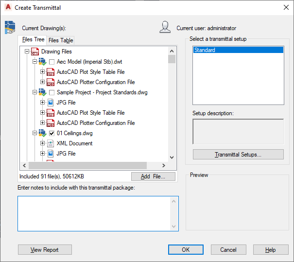

    The Create Transmittal dialog box is displayed.
  4. On either the Files tree tab or the File Table tab, select the components to be included in the electronic package.
    The Files Tree tab displays the included files sorted by type. The Files Table tab displays all files in a list view. You can sort the list by name, path, type, version, size, and date.
  5. Click OK to start the electronic transmittal.
