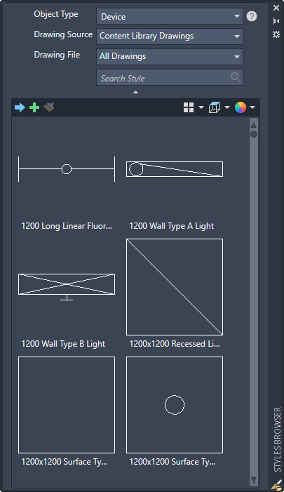

When you add a device, panel, or part to a drawing, you can use the Properties palette to choose a style to represent the new equipment.
To Select a Style
  1. Enter DEVICEADD, PANELADD, PLUMBINGFITTINGADD, or SYMBOLADD command at the command line.
  2. Click Home tab Build panel Tools drop-down Properties .
  3. On the Design tab, click the icon in the box labeled Style to display the Styles Browser palette.
  4. Depending on the command started, the object type is automatically selected in the Object Type drop-down.
  5. Select the drawing source and drawing file from the drop-down lists.
  6. From the gallery, choose the object style or search for the style name.
  7. Select the style you want to use, and
    • Click to import the style into the drawing.
    • Click to start the command using the selected style.
    • Click to apply the selected style to an existing object.
    Alternatively, you can double-click on a style to start the command and import the style to the drawing.
