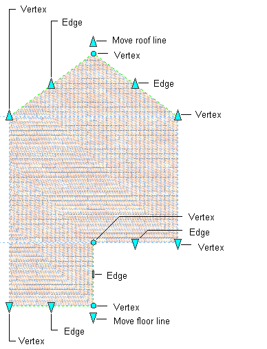

You can also edit the roof line and the floor line on the Roof/Floor Line worksheet on the Properties palette.

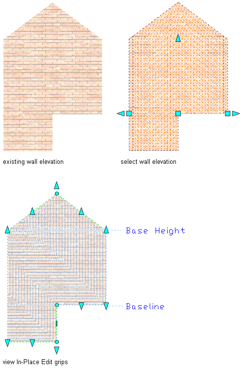

Viewing Edit In Place Wall Elevation Grips
Note: If you want to project the roof line or the floor line to a polyline, draw the polyline before you start this procedure.
  1. Select the wall that has the roof line or floor line you want to change.
  2. Click Wall tabModify panelRoof/Floor Line drop-downEdit In Place.
    A temporary profile is created for you to edit the geometry of the roof line and floor line.
    Wall Elevation Edit In Place Grips
